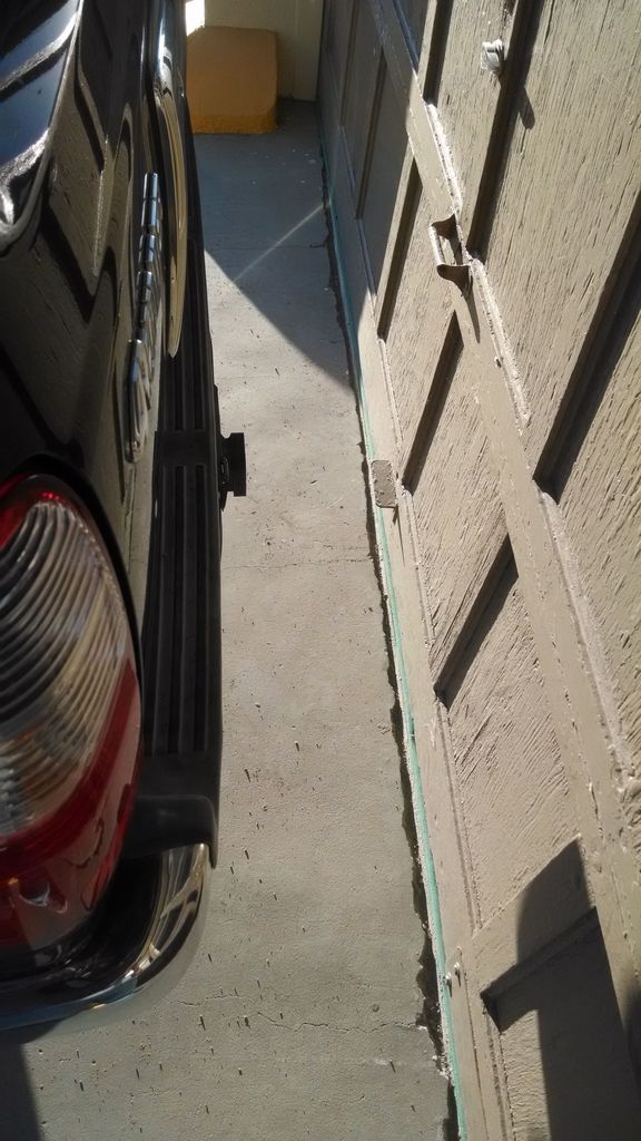

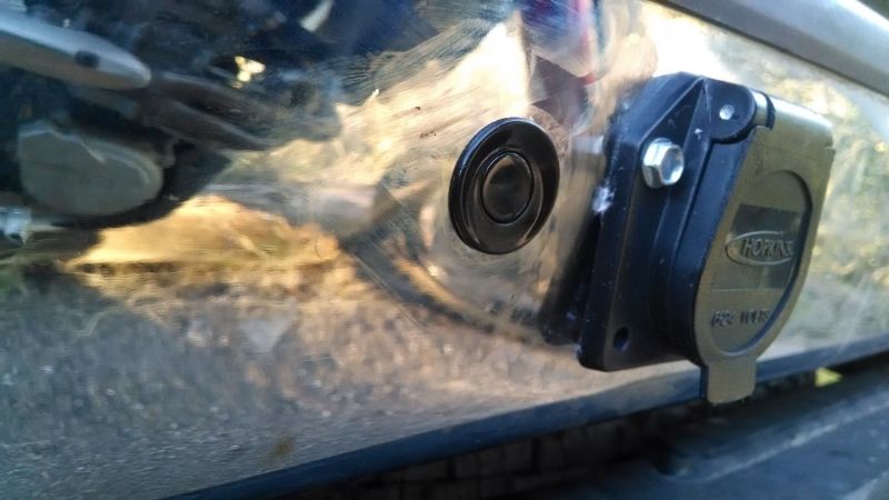

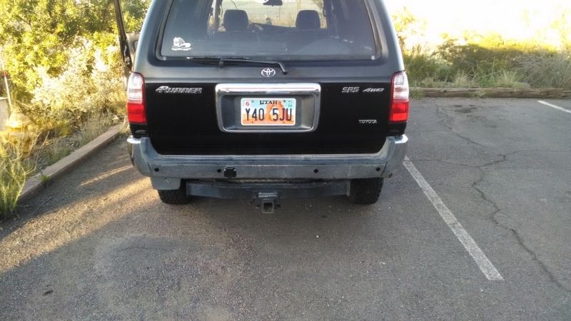

So I finally decided to do a mod I've wanted to do for a long time. Ever since those backup reverse sensors came out I thought it was a great idea.
The last few years china has been pumping out a cheap sensor kid for almost nothing. The reviews s looked good enough so I figured I'd give it a try.
I choose this kit because it was dirt cheap and I only wanted the sound, and didn't like the look of the cheap plastic screens.
Amazon.com : Car Parking Reverse Backup Radar Sound Alert + 4 Sensors Black : Car Electronics
I tried using the included drill bit bit it could barely scratch the metal bumper before it was flattened. So back to amazon for this awesome little kit from Amazon. It's a great addition to my tool box.
Amazon.com: Neiko 10197A 5-Piece Step Drill Bit Set with Metal Case, SAE: Home Improvement
Everything went smoothly once I had the right tools.
That's grease to help bit not squeal so much.
It works pretty amazing so far, has a little trouble with plants since they are not continuous but walls work great. This picture is the distance when the beep is solid. So it's the Stop backing up beep!

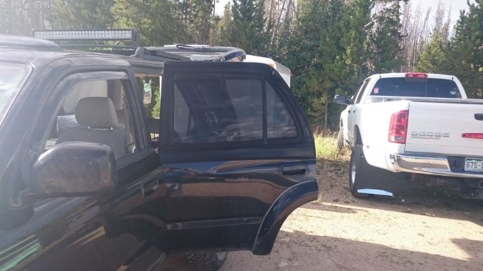

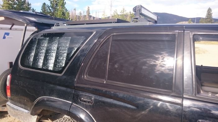

As all of you with a sunroof know when its open that little bar that pops up to deflect the wind gets very annoying and ive been meaning to deal with it. Also the light bar up top causes a little buffeting at high speeds so I was hoping to fix both with a sunroof visor.
Also I had been looking at getting in channel window visors as well since they work so well to let the heat went out when the car is parked to help my 12v fridge and also are excellent when camping in the rain.
Everything was an easy install and i'm very happen with both. Sunroof open is very quiet and it fixed the light bar noise!!
all 4 windows cracked and sun shades in windows keep the car cool and batteries happy :bravo:

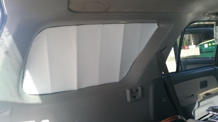

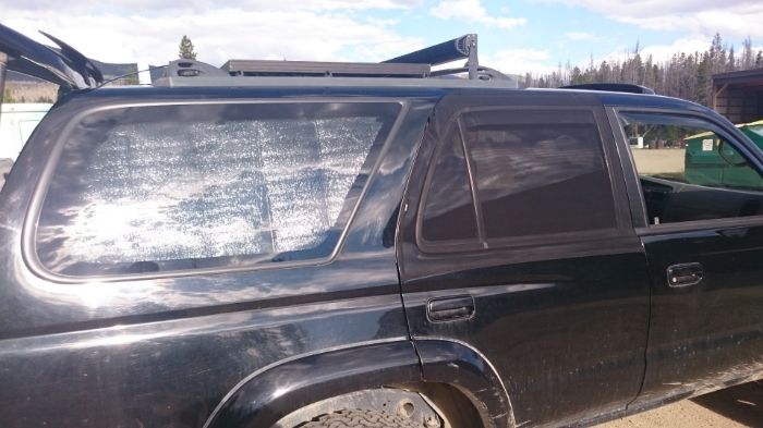

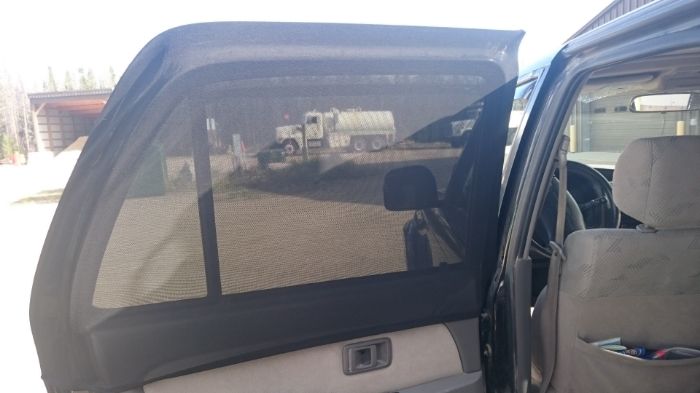

I often sleep in my car at trailheads or in truckstops when traveling. One thing i hate is cars driving my and lighting me up inside the car. It would be nice for a little privacy so after looking at other people options I decided a few things would work.
1- I bought a few cheap window sun reflectors and cut them out to the shape of my back windows and velcrowed them on.
2- I had seen bug nets for off road vehicles but they are always going to be $60+ shipped so I never went for it. I also saw that amazing idea with the plastic gutter grate. But when I stumbled upon these on amazon for $20 shipped I went for it and could not be happier.
If I want extra cover for middle windows I just slide the precut reflector under the window sock.

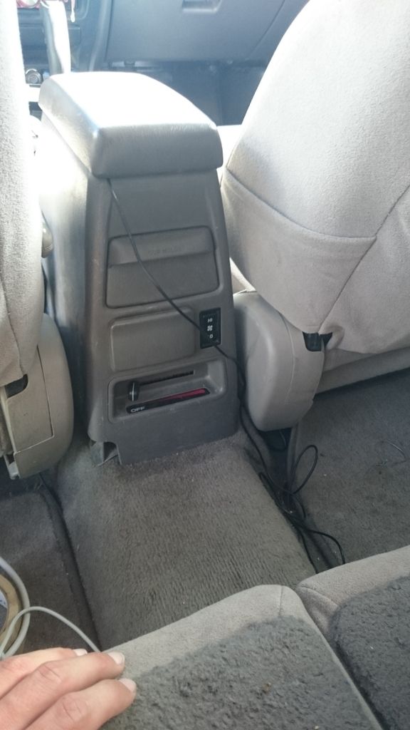

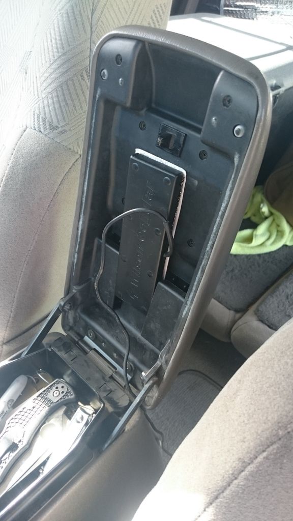

So before the big death valley trip i did a quick install and eventually Ill clean it up a little but for now it works since I don't use the back seats.
I put everything in the same places as the 3g booster but since this one is wireless I ran the wire under the center console and tucked the antenna into the credit card holder. It works amazing, like it was made for it. I just need to unbolt the center console and run all the wires under the carpet eventually.
