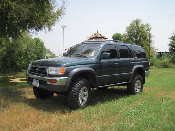

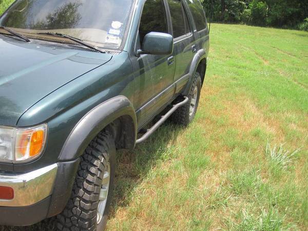

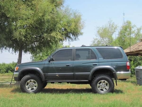

My 255s rub on the bolts for my limited flares when the suspension is completely compressed. The 255s are narrower than your 265s and will clear your ucas fine.
SamSter0077
SS1.2, 255/85/16.. No rubbing, stock UCA and wheels. Anything that rubbed was plastic and cut, no big deal.. As I recall, under flex and turning the tires rubbed on the bottom of the front bumper. Went away when I got the ARB. I think you will be fine.. oh, and no need to regear unless you want to crawl over something IMO.

SamSter0077
SamSter0077,
Thanks for posting the photo. Your 4RUNNER Looks really good with the 255/85/16 !
Any body lift?
Steve from SS said i should no have a problem.
Thanks! It's got a few dents now.. :(
no BL, Steve at Sonoran knows his stuff.. if he says it will fit, it will.
