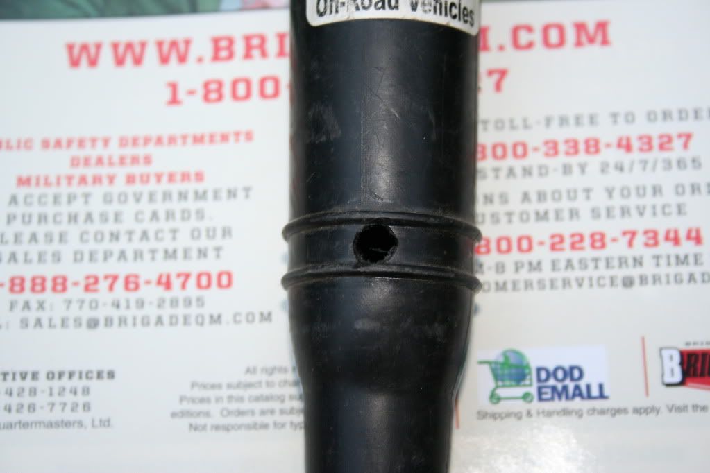

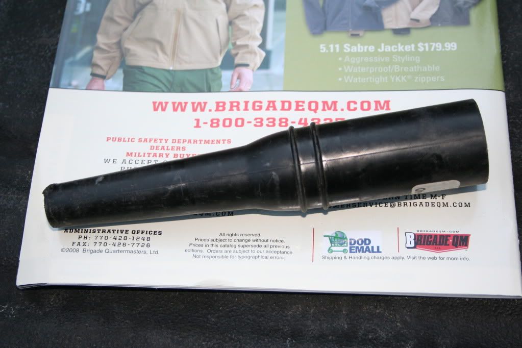

It came with one of my small 2 gallon cans. It is a funnel meant for when you use the can to fuel a vehicle instead of a lawnmower. When I used it, it worked, but took FOREVER (read over 10 minutes) to empty the can. After looking at it a bit I had an idea.
First, when you look at a CARB spout, you can see the hole for the air to go back in the can (to releave the presure/vacuume build up) In the photo below it is the hole in the middle.
I measured up the "funnel" attachment and found where the hole would need to be on the funnel, then drilled it out.
Then slide the "funnel" over the spout, making sure the hole you drilled is lined up with the hole in the spout.
When I use this setup, modified like this I don't spill a drop, and the can empties in just under a minute. I don't have any issues at all now. I can drain 4 cans of fuel into the truck faster then I can fill it up at the gas station, :wings: and do it the "legal" and proper way (not that that is important, but coming from my background it is kinda cool when I do it legal)
