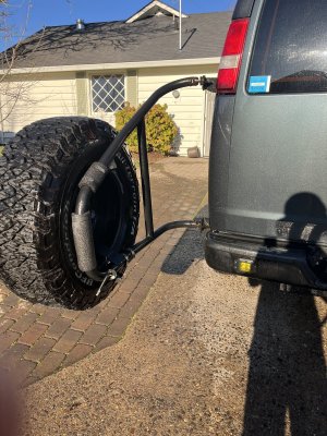

The only reason I was asking for "upsidedowns" is because it looked like you ran a vertical piece of tubing rather than attatching the hoop directly to the brackets... I was thinking of going that route rather than what Scott had. If its easier just text me a couple pictures 705-917-2246.

The vertical tube is just there for support but not related to the brackets. Happy to send you a couple pics.
Attached, sorry meant to post these last weekend
