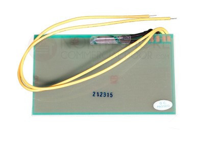

I looked at those heater pads. What I’d really like to do is figure out a temperature activated power switch, that would turn on a heat pad at 35 degrees or so and off at a slightly higher temp. I found some that looked like they could work but the temps for turning on/off weren’t what I wanted and the real deal breaker was that they were all 120v
Links are just a few post prior. I posted link to what I thought to be favorable to control the heating pad. Those thermostats I post should work fine with DC voltages.
If you want an economical heater try universal seat heaters. Use just the heating pad and the above tstat.
There are a bazillion different snap-disk thermostats. Tons are used in HVAC and are usually 24v. The one I posted clearly states:
"Models with operating temperature ranges from -45C to +425C" (first bullet point)
This other page says:
"These robust thermostat switches can be used in high current applications; carrying up to 25 amps at 240VAC, for over 100,000 cycles (30 Amps at 12VDC for 30,000 cycles)."
http://senasys.com/automatic-reset-thermostat-options
Shouldn't be too tough to find one normally ooen that closes at 35F and opens at 45F.

You can treat the resistive heating pads as plain resistors. Putting them in series, reducing or increasing voltage to adjust output power. (consult ohms law). The thermostat should be placed in a location that will respond quickly to changes in case temperature. This will prevent spot overheating.
