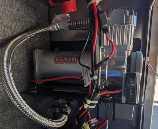

I've gone tankless on my last two OBA setups. I have mine setup for automatic inflation shut-off, which is really nice because I can set the pressure I want and just walk away until the compressor shuts off. (Usually I use that time to do a walk-around inspection, etc.)
I started by basically copying this setup here, except that I added more QDs so I can plug in the regulator or leave it out, if I need full-flow. I set the regulator to the desired pressure, and when the tire comes up to that pressure, the backpressure in the line causes the compressor to shut-off. My current OBA is plumbed to both sides of the truck, with 200psi line (and the auto-shutoff is at ~90psi), so I can plug in the regulator and hose on either side. Post-regulator, I can use regular coiled hose (which is usually rated to ~100psi).
