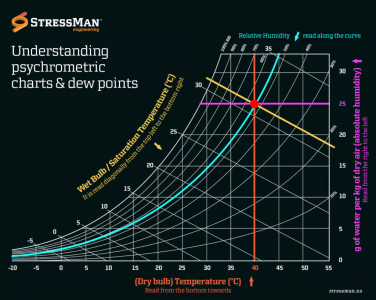

Thanks for the discussion, that is what my instincts told me. For winter camper applications, raising the interior temp also raises the amount of moisture suspended in the air, which encourages condensation at those points where cold is transmitted through from outside, ie, widows and doors. Frequent air exchange with dry outside air is the way forward but one must address the attendant need to heat that air. It brings me back to considering an HRV setup…
