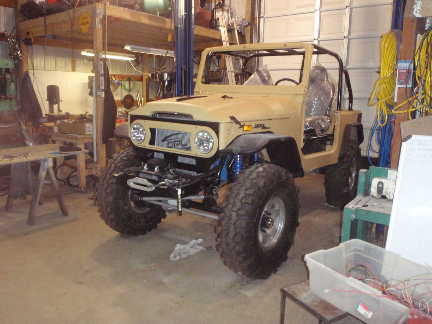

It's funny, I have a picture of your cadillac motor when I sold it to you in front of the 'cruiser
and I still have no idea where (or even if I should) post the build. It's far more domestic the '40....
Yeah, the Caddy motor is all torn down to the short block level. I'm going to keep as many parts as possible, such as the power steering pump and alternator (which I may have rewound to a higher amperage rating). I need to call Pacific Auto Machine to schedule a time to bring the block over to them for inspection and machining (if any). The Cadillac engines idled so smoothly, that balancing may not be required. I have a cam spec'd out and am going to bite the bullet on a complete roller valve train. It's just a matter of finding the time at this point, which is good, as I don't want to rush a project.
Rush or not we are all looking forward to seeing your motor go in... Nice looking Toyota. Is that a Chevota?:Wow1:
