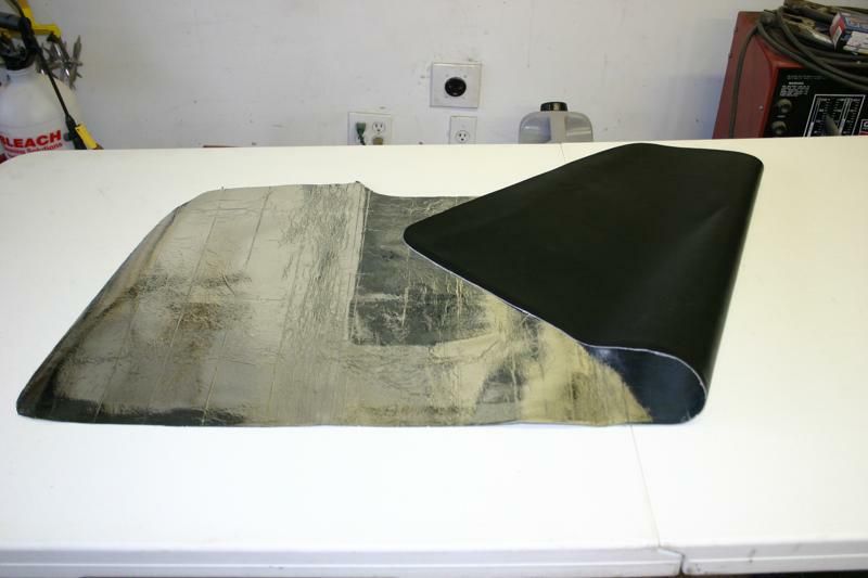

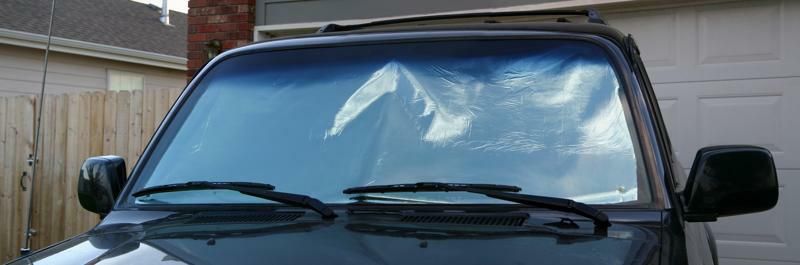

Also, the mylar / vinyl idea is great. I was originally going to go a similar route with the bubble wrap / mylar insulation from Lowe's, but I like your approach more.
