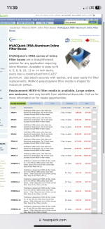

Im wanting to use it for creating positive pressure to keep dust out of my truck canopy (while driving) and possibly just ventilation in warm or rainy weather
I would be using a similar filter set up as pictured to filter the dust out. Also any insight into which MERV level i should get and if this is practical. ie not too restrictive?
The goal is to just keep things from getting dusty. I imagine a MERV 5 or even lower would accomplish that but i have zero expierence

This is completely a guess, but my guess is that most of the small Diesel Heaters / Chinese Diesel Heaters don’t have a fan powerful enough to draw through that filter or create much of a positive pressure in a camper sized space. It would probably be something you could measure with a decent manometer, or just do because you want to, but theory and reality are probably far apart in this case.
Yeah all i can do is guess at this point. I feel like it doesn’t take much positive pressure or flow to stop dust from coming in. The restriction from the filter is the biggest variable in my mind.
Regardless if i use CDH to keep dust out or not i will be setting up my diesel heater the same way. The only thing i would be adding to the system is the filter, which i can do some experiments in the garage before i install in truck and see how it goes
