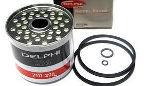

I run the simple CAV filters - very cheap, and you can get them anywhere here in Australia at least. HDF296 filters are 5 micron, and 45l/hour, which I find is enough for my 200hp OM352A. I see people fitting much larger filters where a replacement cost $100 or more here. I pay $10 for the HDF296 at the local spares shop, and can buy a pack of 10 for $70.
That means I can change the often and not worry. We once got a tank full of diesel that was dodgy, blocked up the filter within about 20km of filling up. I was able to save the diesel by just transfering it across to the other tank through the filter, took two filters to get the whole lot transferred but $18 saved me 180l of diesel. It pulled out all the dirt and the water. I have a Facet pump upstream of the filter to help prime it, so makes bleeding the air out very easy. The glass bowl shows up any water contamination as well. I normally buy a pack of 10, and have them in the truck, so alway have them on hand just in case. I find that if the filter is blocked, then I start to loose power up the steep hills. The EGT gauge just drops and the truck feels sluggish. It take me about 10 minutes to swap a filter over, I have a small bucket I catch all the diesel in and bleeding is easy with the pump. I put the dirty diesel in the small jerry can I use for as a kick start for campfires. The old filter I seal up in a bag, leave it in the little bucket and throw it away at the next service station.
They should be available worldwide, there are lots of equivalent filters - about 275 according to the fuel filter cross reference website.
