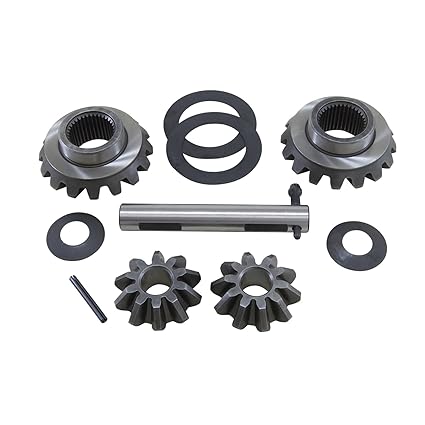

Spider gears and cross pins have no bearing, just splash lube.
When your diff is diffing, those spider gears and side gears get nuked fairly quick. I've replaced plenty of wobbly gears and worn down cross pins in 1980's GM cars. The kings of one wheel peel.
Keep your speeds under 55. I'd get another wheel and tire. Keep the spare. So you can have two flats and still get home.

5% is no big deal. The relative speed of the spider gears at 55mph or even 70mph is not high enough to cause them to wear the pins excessively if your diff fluid is at the proper level. Look at it this way, many new cars and even some TRUCKS come with mini spares. They likely have a 5% or more difference, and cause no damage as they are frequently driven for thousands of miles by the financially strapped, lazy, or unknowing.
Second example is the front differential in most 4wd trucks, which uses an axle disconnect. In that setup, the diff case stops with the driveshaft, and the spider gears rip as one shaft turns with the tire and the other turns the opposite direction. That's at no load, but my truck has been doing that for 270k miles and still the front diff is fine.
If you are really concerned, or need to use the locker some to get back to civilization, you could always put the spare on the front and swap the good front tire to the back.
