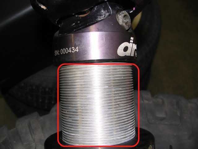

I know the Donahoe Coil Overs are set at 2" of lift from the factory. Does anyone know what the correlation between exposed threads vs. lift setting for the Donahoe coil overs (see picture).
I know that actual lift will vary from truck to truck but I wanted to know where my used Donahoes were set at. The exposted threads is 61mm (2.4" or 2 7/16").

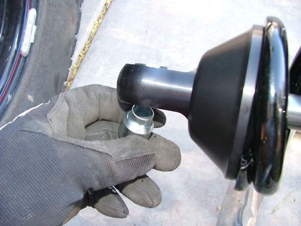

I partially tore down the Donahoes last night for a clean, inspect and prep session. I did find a missing set screw for the bottom collar that screws into the shock can. If anyone ever needs one they are a #10-24 UNC x 3/8" long cup point socket head set screw. I found some locally and will replace it. I'll also use blue loctite to secure it in place. Pictures to come this evening.
Here is a picture of the set screw in question.
This is the one that was missing.
I'm hoping to install on the weekend as long as the lower heim joint spacers arrive in time.

Does this help? I haven't cranked them at all - standard Donahoe setting.
(you can see how those threads get packed with dirt!)
Pete
Pete,
That's a good start! I count 18 thread "peaks" and will see how that compares to my coilovers tonight.
Thanks for the info.
Cheers :beer:,
P

Will have to look, not sure if I have old/new vesion, but mine came w/ exactly 2" between top and compression ring.

I just got off the phone with Donahoe Racing (951-279-8000). Great guys to deal with and very helpful. So for anyone else who needs to know the come from the factory with 1 3/4" of thread showing see pictures below.
The figure is only valid for the older style bottom coil seat as shown below.(photo credit Expeditions West):
