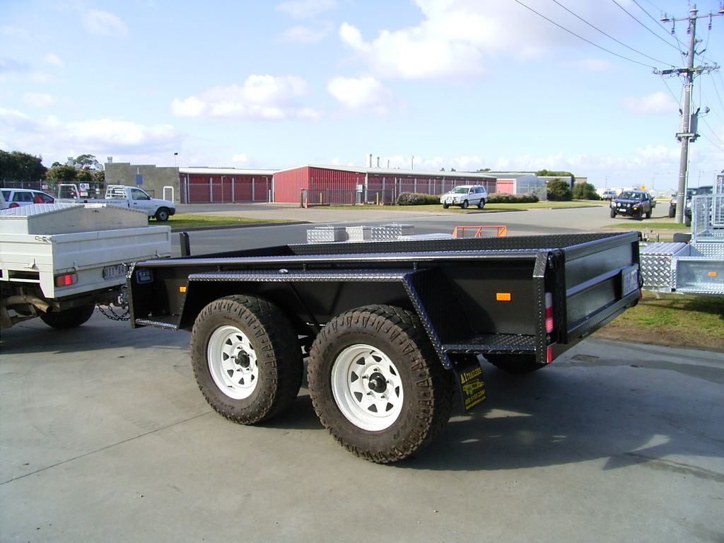

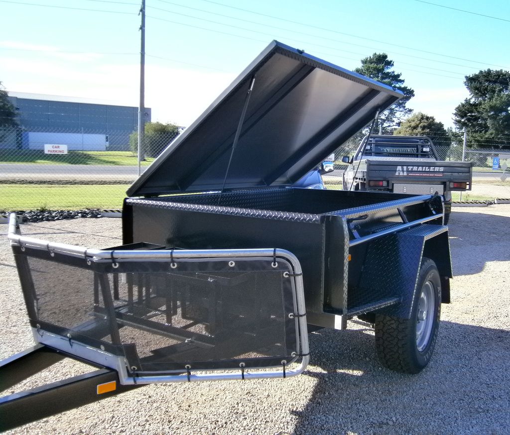

During my down time I ran across these Aussie utility trailers (mostly with front and rear drop down gates)
http://www.mackaytrailers.com.au/tandem.html
http://www.a1trailers.com.au/trailers.htm EDIT: Website shut down. Replaced picture links...
Tandem%20Box_zpsczfwhmvw.jpg~original
RIMG0006_6_zps3ybt66pb.jpg~original

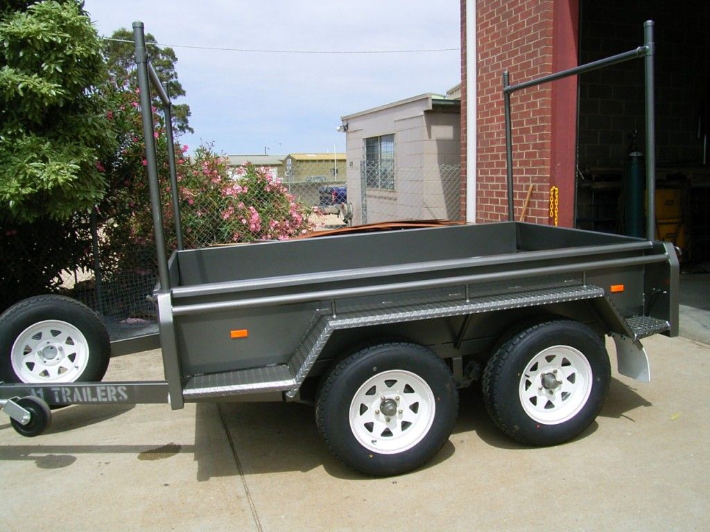

I also liked this very simple single axle model...
Off%20Road_zpsut7qtule.jpg~original
