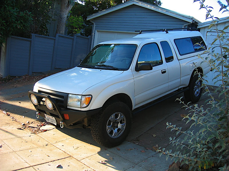

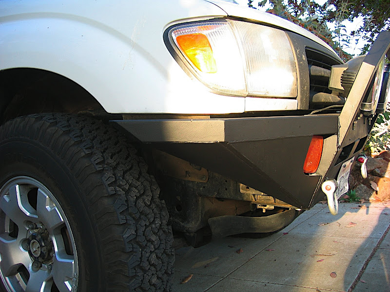

I'm about done with my front bumper. Apologies for the lack of progress pics, I was on a roll and didn't take many.
Objectives for this bumper (some are reasons I didn't just buy an ARB):
-better protection
-better clearance
-better approach angle
-jack points
-recovery points
-relatively light weight
-a fun project!
There's no provision for a winch, for now. If I do decide I need one I'll add 2" receivers to the front and rear of the truck and use a portable winch on a hitch.

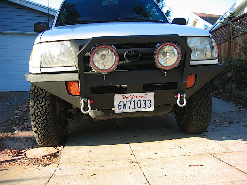

Above the rectangular cutouts in front is the 4" x 4" box steel main member. I can slip a hi-lift in there to jack, or just level the vehicle when camping.

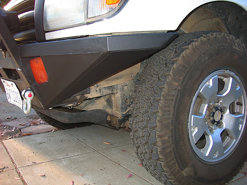

Changes I'm considering:
-adding some plate in the triangles where the turn signals are, and maybe between the frame and the end of the fender returns.
-adding skid plates from the bottom of the bumper, extending back to the crossmember and t-case.
-relocating the washer reservoir, as you can see in the pic below, it hangs down a fair bit below the protected area behind the tubular stay. If anybody has done this, or has any ideas, please let me know.
This is an easy fix. I just finished putting my Tacoma back together and all I did was drill a hole in a Nalgene bottle, transferred the squirter pump over into the new windshield-wiper fluid container (the Nalgene bottle) and then clamped the nalgene bottle to my rollcage using two poly shock reservoir mounts and hose-clamps. you'll have to come up with another type of mount, and some other type of container might work better for you, but it's stupid-simple in any case...
Nice job on the bumper, by the way.
dustboy
all I did was drill a hole in a Nalgene bottle, but it's stupid-simple in any case...
I like simple solutions. I'm sure I can find some space under the hood to do a similar job.

I finally got around to finishing the bumper last weekend. I added a hoop to protect the rally lights, and plated the open areas in front of the tires.
IMO it looks much better now, you can't see as much guts through it. And the wings that protect the front of the fender are better supported.
Unfortunately I did have to remove the washer reservoir, I will have to mount a bottle elsewhere to replace it.
Did I mention I LOVE WELDING!!
