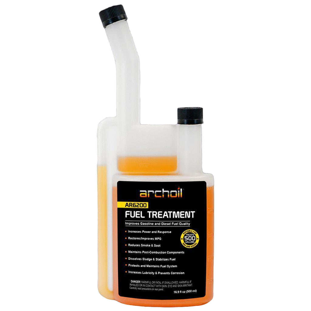

A few days ago it occurred to me I hadn't added any cetane booster to my fuel in a while. As I was just getting set to change the oil and I use Archoil anti-stiction additive I added some of their fuel additive to the order.
Last night as I fired the rig up I thought to myself.. "hmmm.. that sounds smoother and quieter"
Today I fired up the sound measuring app I used last year to check. 55 dB at idle. Had to come to this post to check my numbers. Looks like I didn't record an actual idle but I did check the sound while rolling down a hill nearby. Last year it was 66-67 dB. Today I got 58 dB.
Obviously this is just an app on a phone and possibly not very accurate but it essentially confirms what my ears told me. It is quieter. Which surprises me all to heck.
No affiliation with these guys. But for Canadians they were fast with the shipping and had a better price than Amazon.

Archoil worked really well in my 7.3. Surprisingly quieter and smoother running it.
I never really believed much in additives until archoil.
