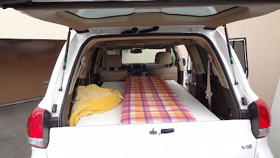

Can You sleep in a stock LC 200 with the second seat folded, is it long enough for 2 people, without any modification
For shure. Just fold both seat rows, the 2nd and 3rd - and put a board over - and you can setup a large bed. 2.10m lengt, 1.6m with - similar to many standard hotel room beds. Just the entry area behind is limited to 1.2m.
This way I spent the first night inside of the car, to get an idea about travelling this way. Here are some other pictures who may help inside of the discussion.
