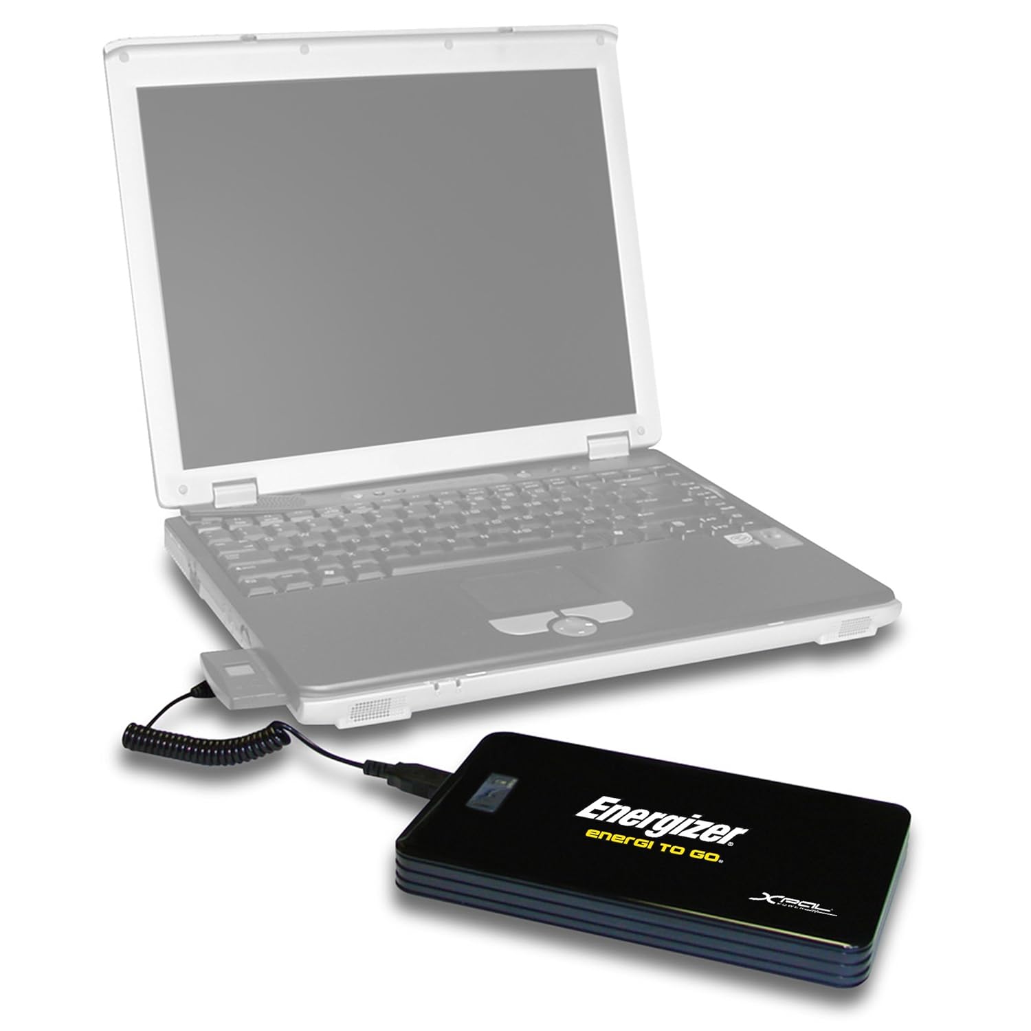

kilimats
I've own countless portable charger in the past, none have exceeded my expectation like this little guy did (it even charger my power hungry laptop for an extra 2 hours!!!): http://www.amazon.com/Energizer-XP18000-Universal-External-Netbooks/dp/B002K8M9HC
It will give you many voltage including 12v of course
Spargman
Thanks kilimats - but I'm looking for an electric water pump to drop into my jerry cans :)
I prefer one i can wire directly to a battery...but also a manual pump as well.
