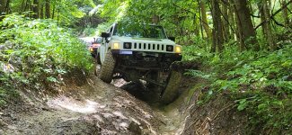

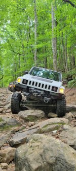

I took it to windrock to test it out:
20240719_143453 (1).jpg20240720_091548 (1).jpgScreenshot_20240721_145546_Video Player (1).jpg
It worked well, coupld of little tweaks and trimming and she'd good to go
Then i took it on the ultimate overland trip...the Rubicon
solid days of driving from Indianapolis to get there and hit the trail. She made it through unscathed, minus the usual scrapes and bruises...I must have done something right during the build process. .
I several underestimated how relentless the trail is. And I know for you vets it's probably not, bit it kicked my ******...but I'm ready to do it all over again.

Biggest takeaways as far as truck performance goes is....I need 40s and to shave the 14b. Both would have made my life 1000 times easier, I will have that done for the next time.
