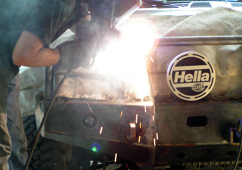

Well, my fabricator and I put in another full day working on the most recent addition. I wasn't planning on showing this until it was fully completed... but aw, what the heck. :wings:
The naked truck, awaiting it's new brassiere:
A little plasma can really spice things up:
Not a bad fit for an initial test fitting eh?
Most of today was spent on fixing minor issues (interference with the grille, headlights, fender alignment, etc, etc.). More details to come whenever more progress is made.

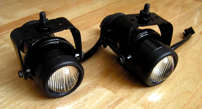

First of all, the fog lights came in for the bumper. After reading many reviews on fog lights, I found that the projector type lights had what I would consider the best 'fog' pattern. I was looking for wide spread, yet a nice cutoff that wouldn't throw light upward. I ran across the Hella Micro DE fogs when reading up an expedition motorcycle thread. After more research, they seemed perfect, so the bumper was designed around their specs.

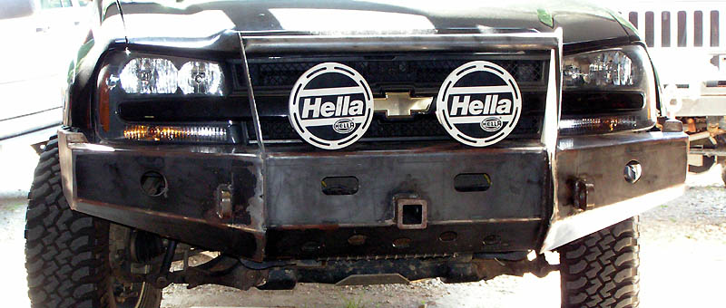

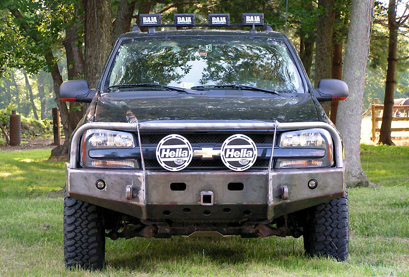

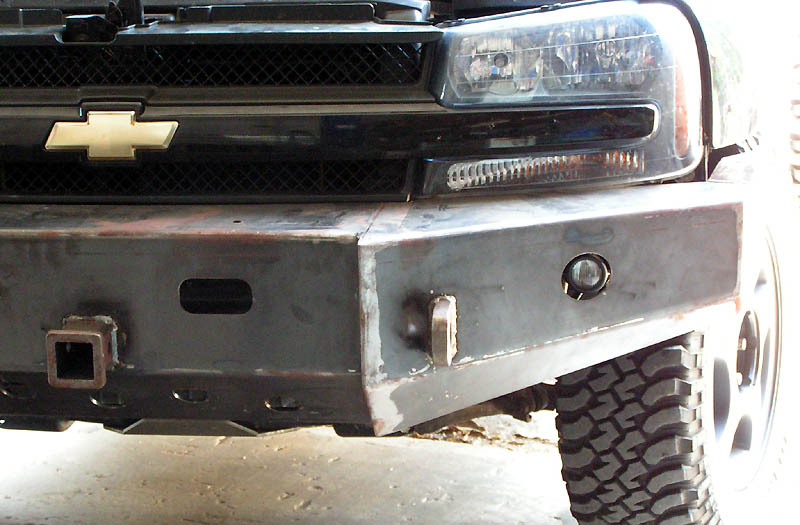

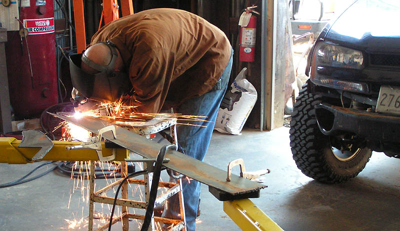

Well I've been out in Mexico for work these past couple weeks, but I finally got some work done today on the bumper.
Cutting out some brackets with the plasma:
Test fitment of the Hella Micro DEs:
Center section tacked in:
Light hoops being tacked in:
Figured I would take a couple pictures with everything in place:
Tomorrow the top end will be finish welded, the final internal structural brackets will be welded in, and the entire thing will be ground down to a nice finish.
Then its on to the powder coater! :wings:
