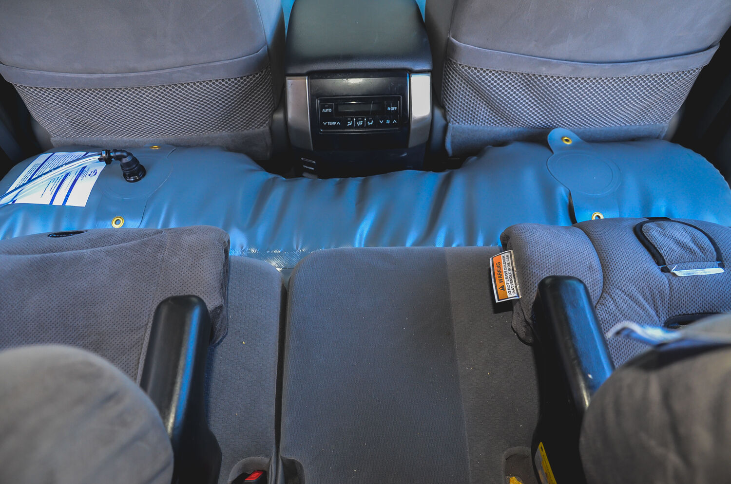

In my landcruiser, I don't have the back seat so this isn't applicable to you but the info might help. I have a 15g water bladder for non-potable water that lives on the floor of the 2nd row (where you'd put your feet). I have a platform built in the second row with a fridge on top and the water lives under the platform. a 5g jerry can lives in the cargo area with a coffee spout mounted at the bottom for easily filling up water bottles w/o removal of can. I take the jerry can into those water filling machine that lives in grocery stores for filtered water.
A water bladder is easy to remove and it implodes on itself as the water level drops. This translates to less water swooshing noise as you drive. It sounds trivial but I get annoyed with hearing water move from one side of a rigid tank to the other while driving and four wheeling. These plastic water tanks that most folks are buying aren't baffled, hence they're noisy, IMHO. If the tank will live in the back of a pickup truck, then the noise doesn't matter.

Which 15g bladder are you using, Ali? I was looking at the AquaTank2, as it seems like it might fit the spot that would be left if I remove my third row seats.
