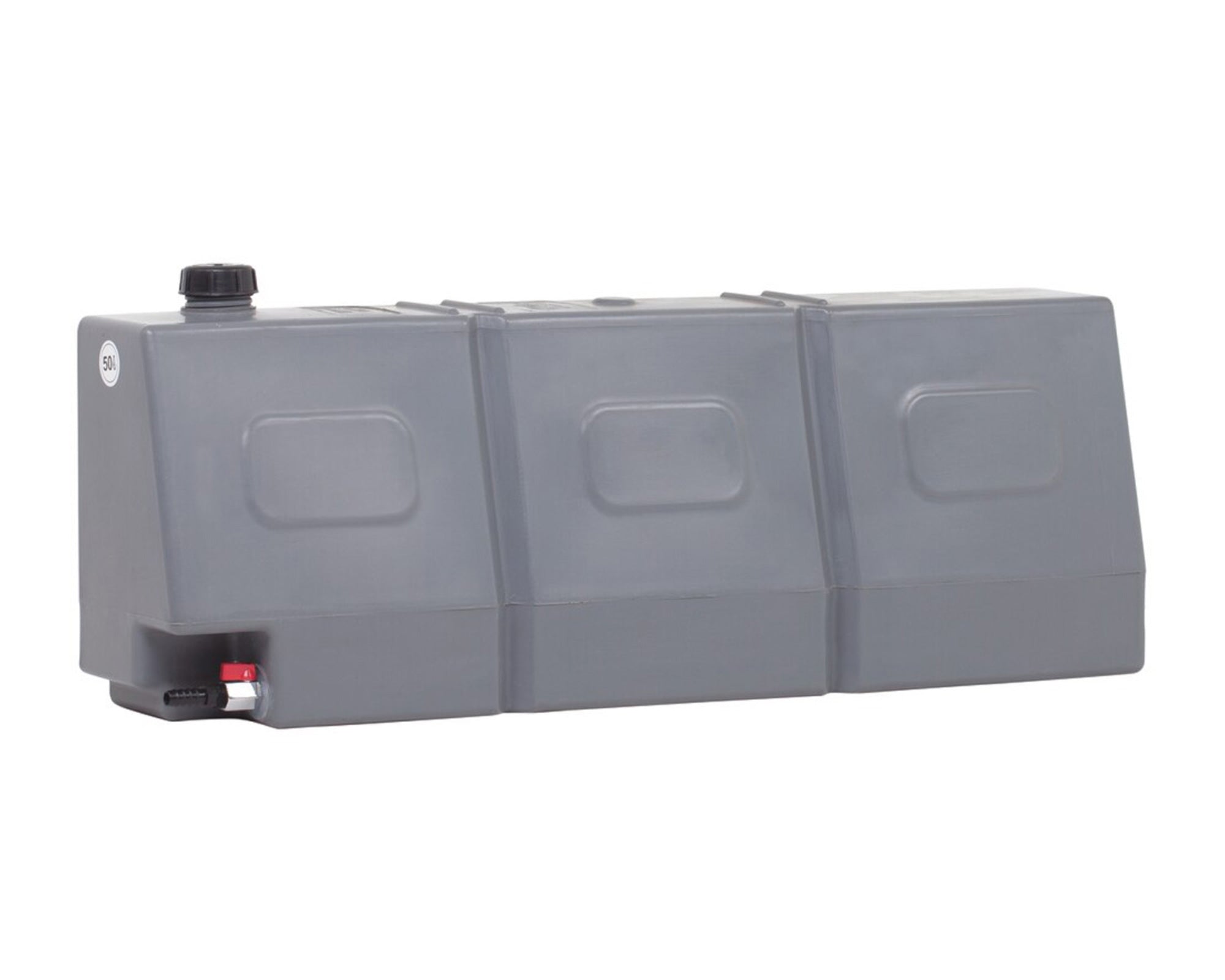

I have a family of four plus a 100lb dog, and the good ole 7 gallon blue Aqua-Tainer is no longer cutting it. We need to double our water capacity in order to go remote for longer amounts of time. Has anyone tried Ironman4x4 water tanks and mounted it to a Decked drawer system? Im specifically looking at this one:
Thought i would mount it to the Deck drawers up against the cab so the significant water weight is as far forward as possible? Thoughts?

I have the 60L (15gal) one in my truck. Its was purchased through Front Runner but I'm fairly certain they are the same product as what Ironman4x4 carries. I have it mounted in a cabinet at the head of the bed. I have it hooked up to a pump with a pressure switch. I absolutely love it. We camped on the beach and cleaning the kiddo and all our stuff off was so much easier. Having that much water on demand means I only need to worry about keeping the gas tank full. Last winter my water lines froze one night. This year I've added a heating pad to the tank and I'm looking for one for the hose.
While putting the weight in the right place seems (and is) important, so is access for filling, cleaning, rinsing, disinfection, etc…. I personally like the standard scepter/LCI water jugs because the are small and light enough to move around for load balancing, fit in standard Jerry can holders, and can be easily expanded (add or remove containers) to match the length and complexity of the trip.
A fixed mount tank has much less flexibility. Have to fill with a hose/ can’t haul to water source. Must occasionally drain and clean. If contaminated might be more hassle, etc…
I still have a 20 gal fixed tank on my trailer tongue, and use it, but I prefer the Jerry cans for most uses.

In our van build, I use 4 Scepter 5 gallon/20 litre Jerry cans, instead of one large tank. And I’ve manifold two of the Jerry cans at once to the water pump and system.
Here’s why:
Easy to fill by simply pulling out one, two or all Jerry cans to fill at a campground, in a grocery store, in an Aqua Purification business or even at a creek or river (with the correct water treatment plan) … really anywhere I can reach by walking with the Jerry can,
Allows me to isolate water sources from a trusted source from a questionable source (in a pinch),
If a “tank” springs a leak, I still have a significant amount of water, and
Allows me to store some water inside the heated habitat while keeping other water outside, really useful in cold/freezing weather conditions.
Every now and then I question if I would use this approach for the next build, until my next fill when I am reminded why this is my chosen strategy.
I works flawlessly!
