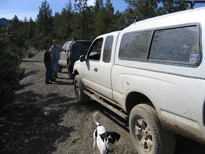

cletaco
7wt, your truck looks great. What lift do you have? Looks perfect with the 235's.
Here is mine at this point (with the 235's on Tundra wheels):
