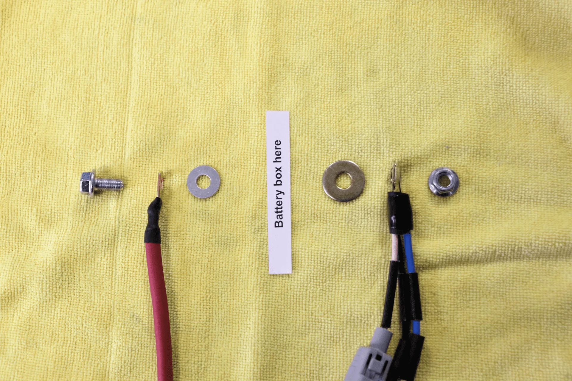

Some clarification on our anti-stress fusiable link connection/set up. By using the included 6 gauge 9" jumper you will be relocating the fusible link to the rear of the battery box. Once relocated they do not see the abuse being out of harm way given when guys upgrade their battery or take them in and out.
Note the red jumper installed to the back of the battery box
Take note of the correct assembly order of the hardware, jumper, and fusible link below. This connection should be very tight using 2 wrenches.
