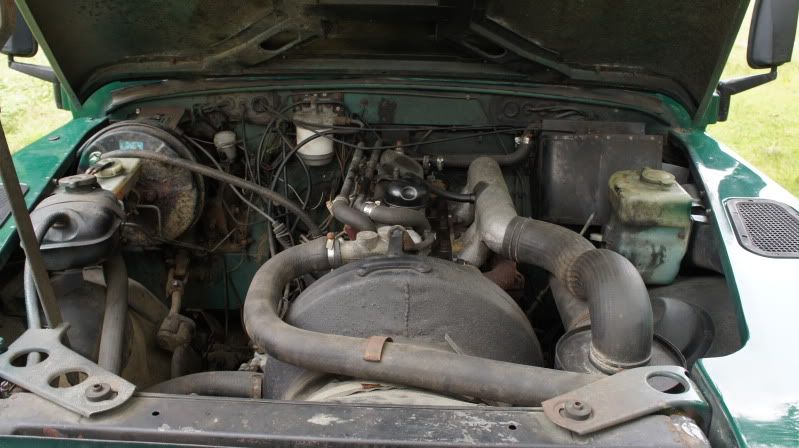

With little tweaking you can get 70 mpg....I got my 2.5na to that speed several times.....but it's a great year defender..those motor are very strong, when you're changing the oil drop the sump pan and change out that gasket.....mine was leaking there when I first bought mine...I don't think you can stop those things from leaking though....here is a pic of mines,Ive done a lot of mods to mine....

very nice! where did you get that roll cage? the front hoop that is one of the first things i want! and believe it or not the engine doesnt leak! but the Transfer case leaks a bit.
Dmljohnson
I made mines....but I buy most of my stuff from lucky8llc.....see Justin...I fabricated allot of stuff on my rig...My 90 was also in pretty good shape, just the little oil leaks...Your 90 looks like it's in pretty good shape, the body looks great....how's the chasis? I had to change mines out....
