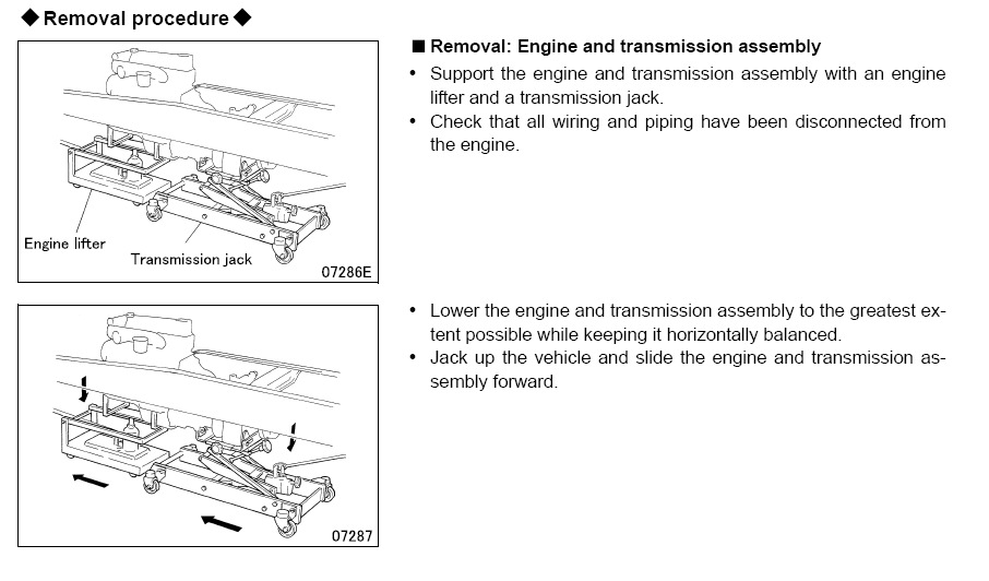

The service manual shows engine and transmission removal from below on the crew cab, with no cab removal required.

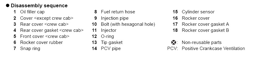

Page 91 shows a disassembly sequence for the rocker cover & fuel injection system that requires removal of the front and rear engine covers of the crew cab only, no cab removal required.

Crew Cab engine & transmission removal:
Crew Cab rocker removal sequence:
