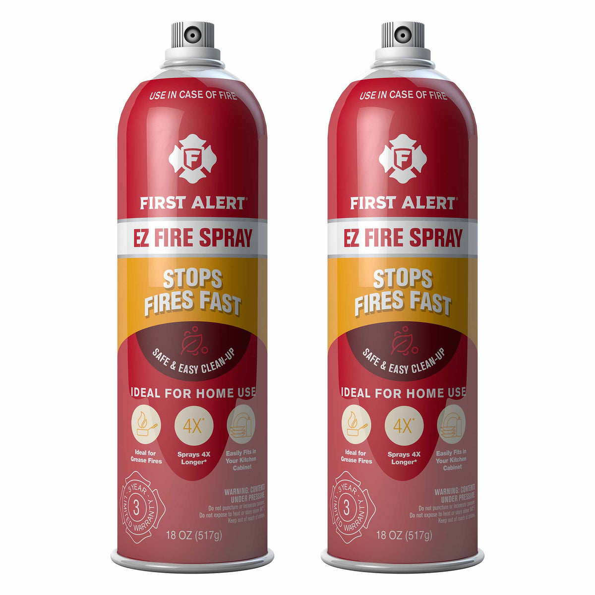

I have one in the camper and one in the cab. Haven't used, and hope I don’t, of course. Really like the form factor and fact they don’t make a toxic mess.
Hmmm, they also have a small range, require you to be close to the fire to reach it, and are not rechargeable. As a former firefighter, I’m very leery of those things. About the biggest benefit to them I can see is the size. As a secondary extinguisher, they look very good, have excellent time of operation but I’m just not sure using them as the primary. I would certainly consider throwing one in the Jeep to replace the small bear spray size single use extinguisher I have the in glove box.

Element work if you can get close enough and there's no wind. Try them as a first go so there's no mess but they need to be backed up with a dry chemical. I've had fires reginite 3x. I had room behind the back seat so I carry 2 - 5lb.
