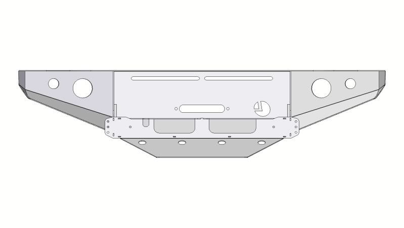

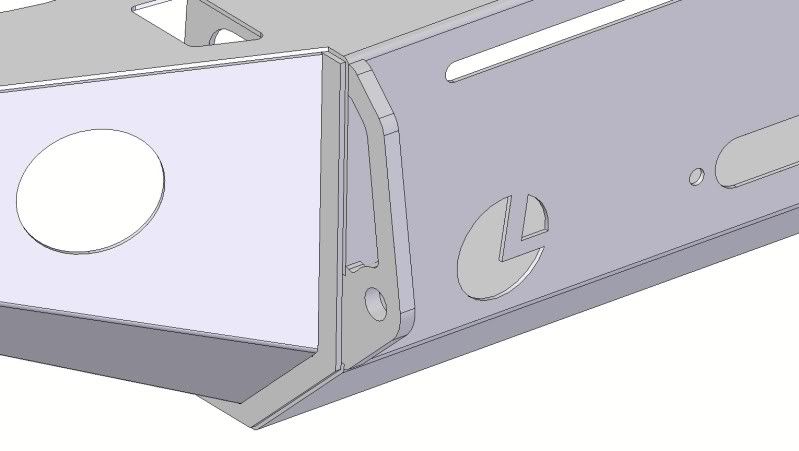

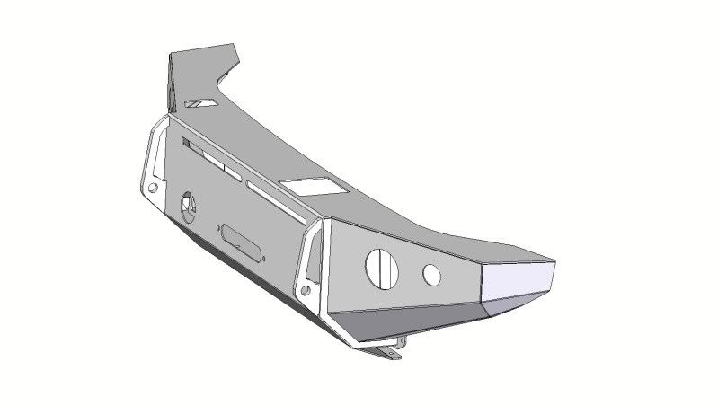

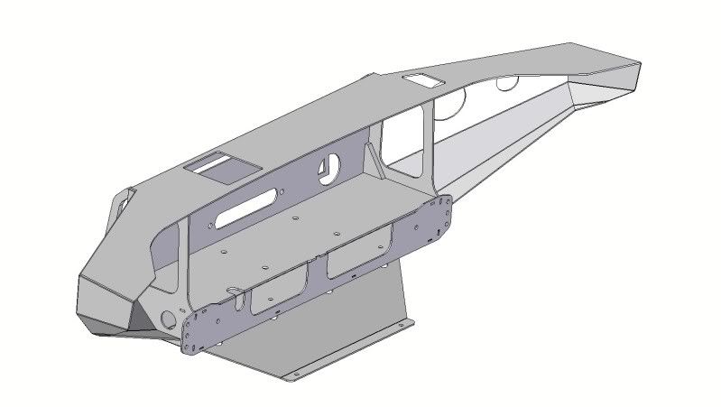

So we finally got our hands on a FJ to design and create a front bumper. We have learned a lot about designing these with our past models. The focus was on strength and ease of instal. The concept always starts with card board, head scratching and a whole bunch of " how is that suppose to work".
So first the designs after templates were made up:

That's a good lookin bumper! My buddy has one of your bumpers on his 4runner, very nice product.
CYi5
I like it, clean lines. The upper tube diameter seems a little small in comparison, I suppose i'm just partial to the size ARB uses on their hoops.
daPitbull
Cant tell from the pics but is it tied in to the frame? It looks like its just mounted at the frame horns. If thats the case there have been issues with winching.
