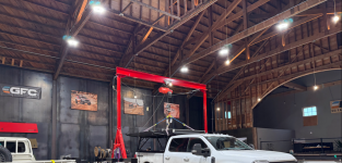

Last week I drove to Bozeman to get our GFC put on. This is our second GFC and we love them. Our experience has been that the GFC is light, unobtrusive, and complements our activities rather than forcing us to work around the camper all the time. Our FWC was a good example of this. Great to camp in but kinda terrible for hauling our stuff around.
