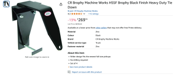

benjeep
Summer 2024
Attaching the camper to the truck
  • Screenshot 2025-01-22 at 14-27-50 CR Brophy Machine Works HSSF Brophy Black Finish Heavy Duty ...png

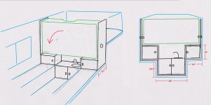

benjeep
Winter 2014/25
The interior design begins with the bed. I plan to use the Murphy bed system.
The space is very small so every little detail counts. There is also the weight that must be taken into account
ITTOG
Well-known member
Looking good. You went 10 years without doing anything to it?
What do you think about those Brophy tie downs on the bed rails. Are they solid and don't move at all?

benjeep
The bed in the camper. The next step will be to build the module that will support the bed and allow it to tilt with storage space and sink
