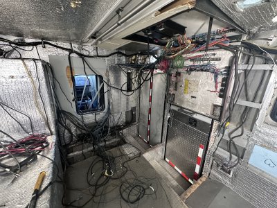

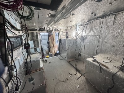

I was removing the A/C in the back, the electrical that goes with it, as well as the electrical in the back that is not necessary for the functionality of the vehicle. Or so, I thought...
Essentially I am in a place where the the vehicle no longer starts. I still get electrical to the cab when the battery switch is turned on however, the gear selector box does not light up. Therefore when I press the ignition button nothing happens. I am assuming the problem lies with the transmission either not getting power or something of the like?

The electrical seemed very daunting at first but once you chunk it all down to its smaller parts and remove the rear A/C wiring which is basically 75% of what you see here - it’s not so bad.
I’ll keep all the vehicle functions on the v-mux and plan to use some of it’s existing functions to trigger other things.

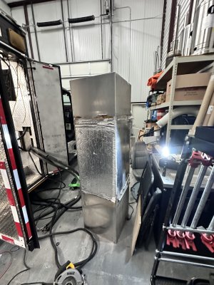

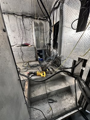

Finally got the backboard storage box out. It frees up a TON of space for the bathroom/utility room I’m planning.
