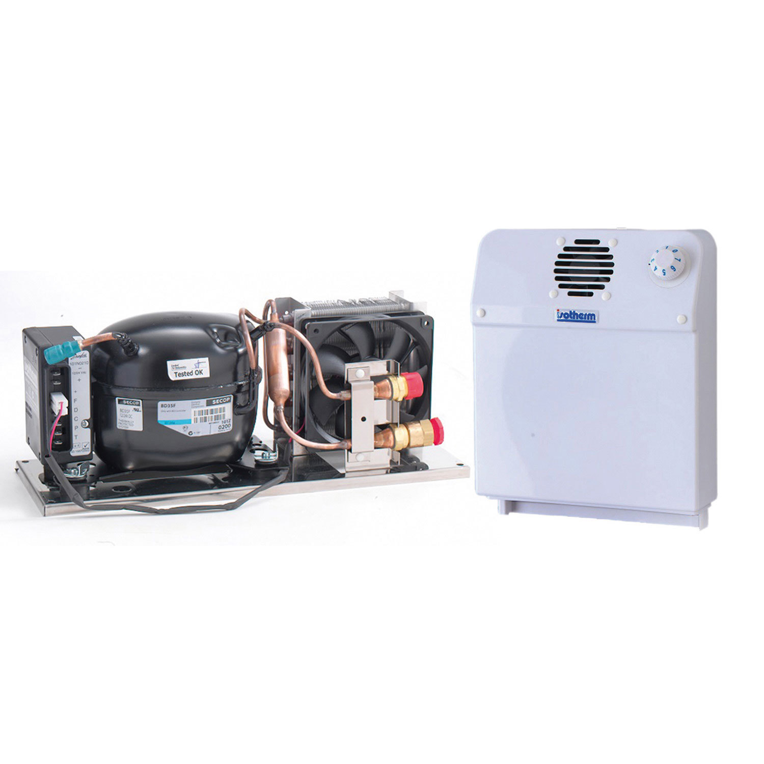

The other option is to make a custom fridge. Danfoss and several others offer standalone fridge kits which include the compressor, condenser, and evaporator. You build an enclosure for them with a door.

Here is that same kit for 650$
https://www.defender.com/product.jsp?id=2383951
This one is fridge only, but you can get an idea of whats out there. The nice thing about these units, is the compressor can be mounted remotely, so you can get more fridge space, and move the compressor wherever its convenient.
Another option is to source a used 12V compressor, and and 120V fridge you like. Swap the compressor for the 12V and recharge with 134A. Mechanical thermostats will work, some will need a relay depending on compressor. Danfoss units have a signal wire which carriers little current, so they are easier than the simpler compressors.
