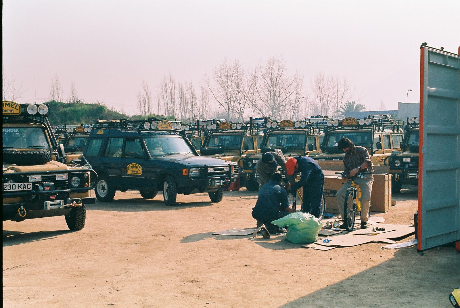

It’s with a bit of a heavy heart( I would like to see her go to a good home) that I’m selling my Tdi Disco. It’s been a great daily driver for the last 3 years but I’m starting another truck build with my son and need the extra space. At least that what my wife keeps telling me:) Listing of everything that has been done is below. It’s located in Nashville TN. I have been through emissions twice since the conversion and tested as a diesel and passed w/o issues. I have attached two sets of pictures links. First is from the conversion and right after it was painted. The second set was taken a week ago. I still have to install the new shocks, and rear wiper motor. Hope to have that done this week. I get asked all the time why it was painted this color. I found this Camel trophy pictures and just loved the color on the disco. See below. If you have any questions please email.

1995 Land Rover 5 speed Discovery 1 (7 passenger). Painted Arles Blue w/ white roof. ( originally silver) Interior is sona grey. This Discovery 1 has a new re-stained dash w/ no airbags, on ABS. The gauges read in km/per hour as this binical has all the correct Glow plug lights and no Unleaded logo :). This rover has ZERO rust issues. I have also been through the doors and frame and coated them with Crest Honey Coat. Truck was repainted in 2012. No body damage or dents, again no rust. Headliner and interior in great shape. This truck has no sunroof ( bonus as it has no leaks) It has a cloth interior and 94 style manual seats. I have all documents on the conversion.
