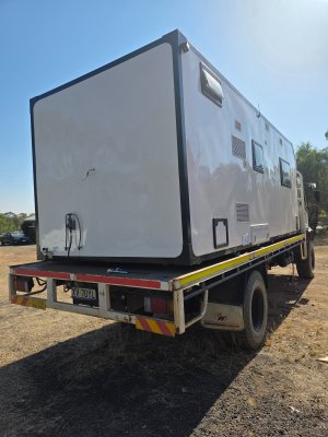

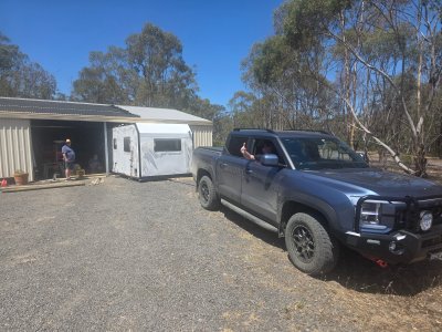

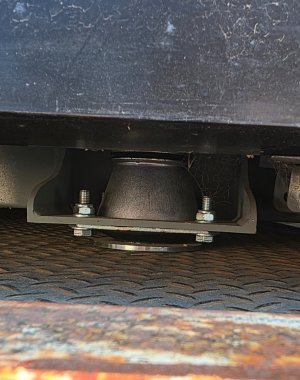

Crickey ! Just checked this thread, realised that I started this project nearly ten years ago, and only just got the cabin on the back of the truck, the project has changed in a few ways since the beginning, the usual problems of lack of time and funds being the major influence, but getting the finished cabin out of the shed and onto the tray (originally was going to lose the tray and build a pivoting subframe, reality put an end to that idea) has got me re-enthused and having it being able to be used by the end of the year is a possibility.
I have attached some pics, the mounts in the picture, I picked up at an army auction, they are what Mercedes use to mount the cabs on Unimogs, the front ones have springs under the tray to allow for chassis flex of the tray. My build is very amateur DIY compared to most builds on this forum.
