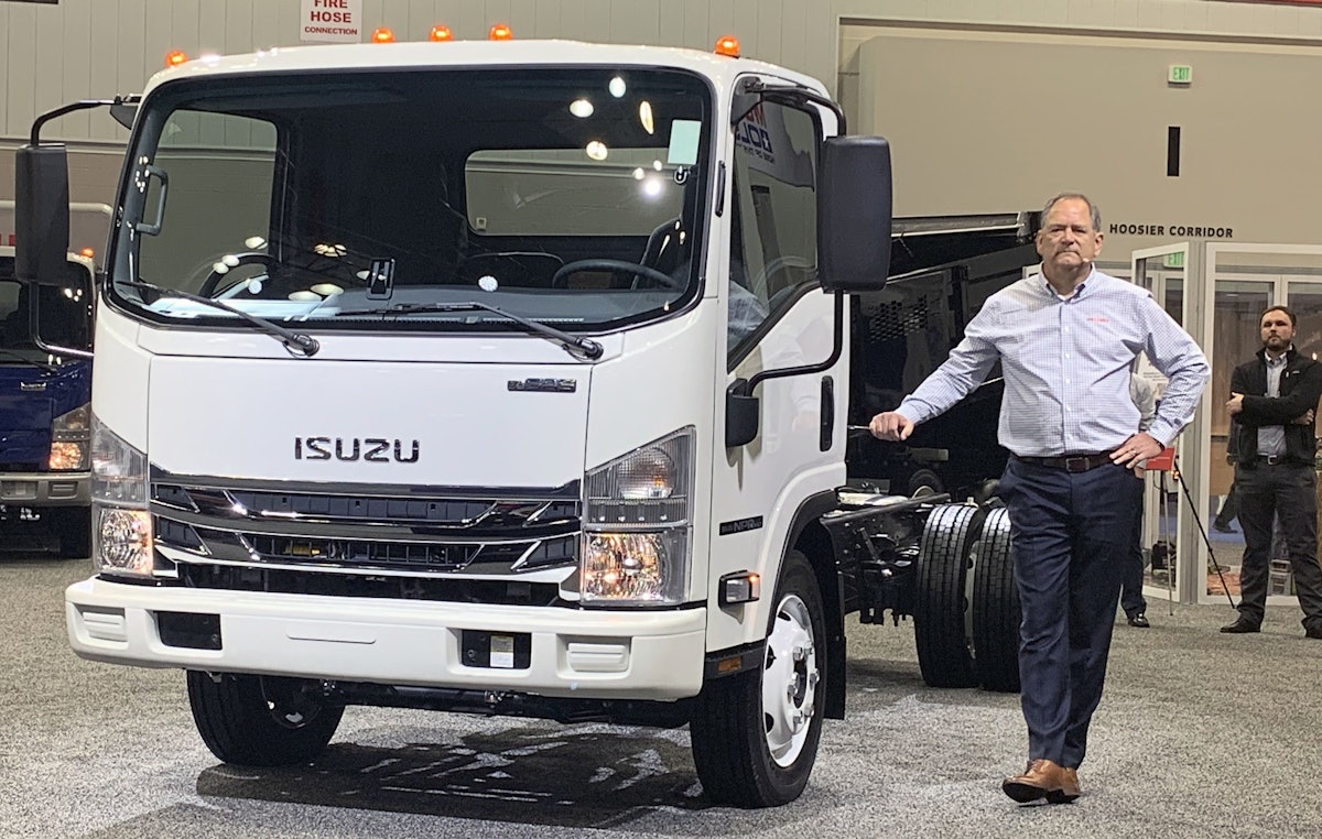

Small businesses are always at the mercy of big business when it comes to decisions like this. You wake up one morning and Fuso says they are exiting your market as part of a business realignment strategy. Capitalism, yay. :( I have no idea, but would hope that a lot of what they developed can be replatformed to the Isuzu NPR (or Hino).
You can make a lot of arguments for the NPR as a superior platform to the Fuso, it's just that Fuso was the only cabover manufacturer with a 4x4 in the US market. In countries that lean towards cabovers for medium duty trucks (i.e. Australia), Isuzu outsells Mistsubishi and Hino combined.

Interesting. Our Isuzu's at work were trash. ************ brakes,problematic transmissions(auto) and smoked like banshees with just over 120K with excellent maintenance. Conversely our Hino's were the most reliable vehicles any of us had ever had the pleasure to drive. My medium duty went 240K with an ignition switch,door lock cylinder,a seeping head gasket and normal wear items. all city stop and go. I never even let the intercooler cool down. I retired 11 years ago and the sucker's still in business. The government forced us to replace the old ones and we went with International Workforce medium duty tiltcabs. Another failure. They returned to Hino's and even with all the government mandated emission trash they're rock solid.

EarthCruiser does build on the Isuzu (with factory 4wd) in Australia so there might be some standardization advantage by going with Isuzu over here...

Wish they would use a 8.8L PSI engine, it's in buses and is based off the GM 8.1L. I work for an International/Isuzu dealership and the Isuzus don't have too many issues if they are properly maintained.
