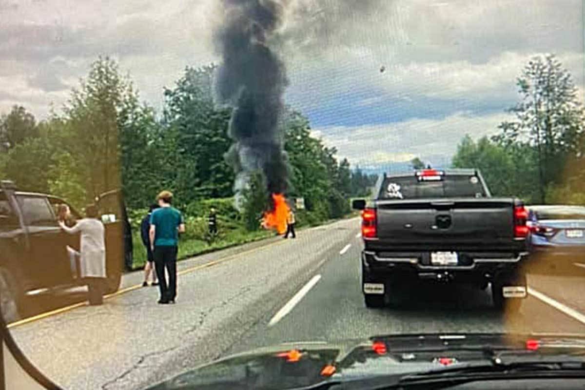

Must admit, after 10 years on a fire department I grew shy of carrying gas containers and this incident in BC brings back that resolve to not do it.
I think your suggestions are contradictory :) And I'm also shocked that you guys have road rage up there. Where they at least apologetic while they were cutting each other off and flipping the finger?
Agreed, trying to be proactive with the exterior carrier comment, then the news reminds me, hey who needs an extra 20 gallons of fuel? And if you do, look at a replacement tank plus auxiliary tank OR BUY the vehicle with the range you need.
But unless you are on an African or Asian expedition, if you are camping in North America, why do you need an extra 20 gallons of gas. I suggest the OP tell us where he is going, there might be refueling options.
On the road rage thing I agree, we usually smile as we flip the bird.
