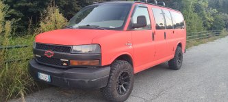

Hi everyone! I've been following you for years and the time has come to introduce myself. I am Italian and I live in Italy, my American dream, looking at your photos, places, your habits and cultures, continues to increase.
In recent years I have researched a lot about these AWD vans, I was lucky enough to find one in my country and the mods began from there. My configuration is 4wd conversion with np241, m/t 285 70 17 light trim, suspension lift front 2.5" rear 2", body lift 1.2", shocks Skyjacker 7000 front/rear, refrigerator 4l60e, shift kit transgo, homemade retrofit projector lens, gladiator coating and van conversion. I would like to add rear differential lock and a rear leaf spring kit. I don't tow but use in mx.. I continue to follow your advice and continue to dream American..
View attachment 802414View attachment 802415View attachment 802416View attachment 802419View attachment 802418
Inspiring work so far, keep it up!
