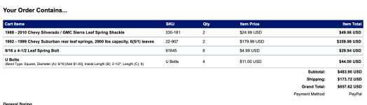

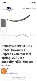

Has anyone put the 4 leaf springs on instead of the suburban springs?
Or maybe just an add leaf for a 1500 Silverado?
I’m not looking for much lift
Just less sag in the back
My van has 3 leafs and no overload
