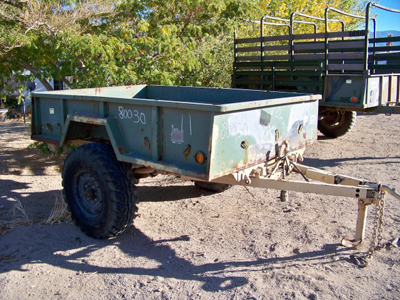

I've owned M1052, M101A1, and M416 over the years. I enjoyed the M416 for camping gear, but I had a Bronco to pull with it. I purchased the M101A1 for its larger size and carrying capacity. I am truely glad I sold the M105 when I did. This is what the M105 looks like behind the Bronco.
Soon after, not much camping so sold it. I've purchased a M101 rolling frame as well and currently use to for a camping trailer frame. Its a bit beefy.
For pricing, I haven't paid more than $250 for. I'm local to a gov't liq site.
