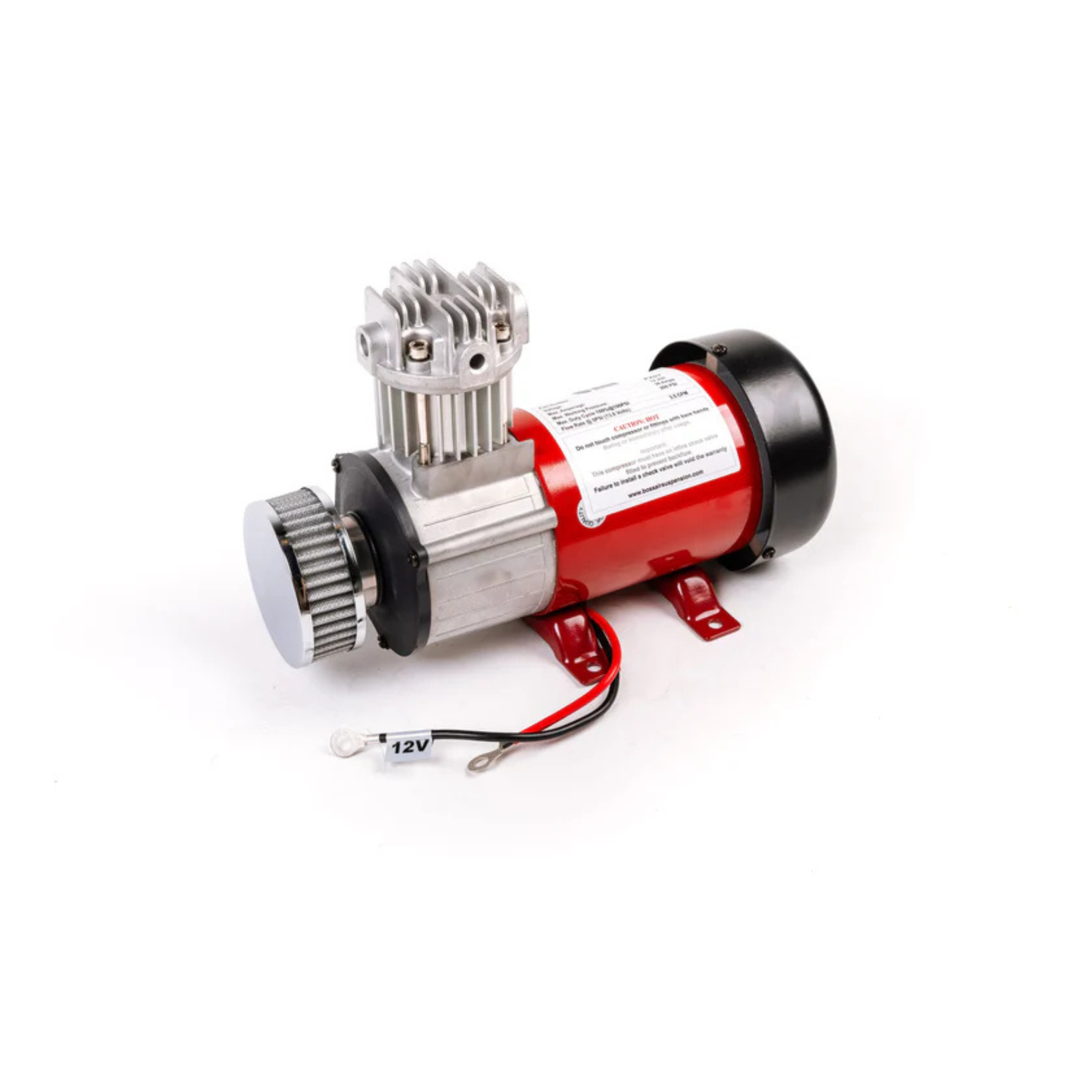

We run a simultaneous 4-up and 4-down system with short connectors that bridge a fitting at each wheel well to its corresponding tire, plus a control manifold at the front of the truck near a large Anderson connector. Most of the piping is internal and not seen. Fast and easy. We air up 4 at a time exclusively. The Chinese pump that Frenchie links to (long link to Amazon) is the same pump we've been using for 4 years in this application -- flawless and fast. Ours is the Ironman 4x4 brand -- but it's the same. When I saw the Orange Terror on the horizon, I bought another (this one called "Vevor" but the same) for future-proofing. Less than $100 for each.
Spending more is silly.
Been using a 12 volt Puma. 100 percent duty cycle. Have two mounted in two different vechicles. Been working fine for me. Just another option.

Re-buildable, 100% duty cycle. After 20 years of service, it is better than a Twin ARB, in my view.
