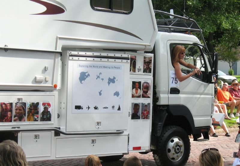

Highlights included being in a parade back in Iowa.

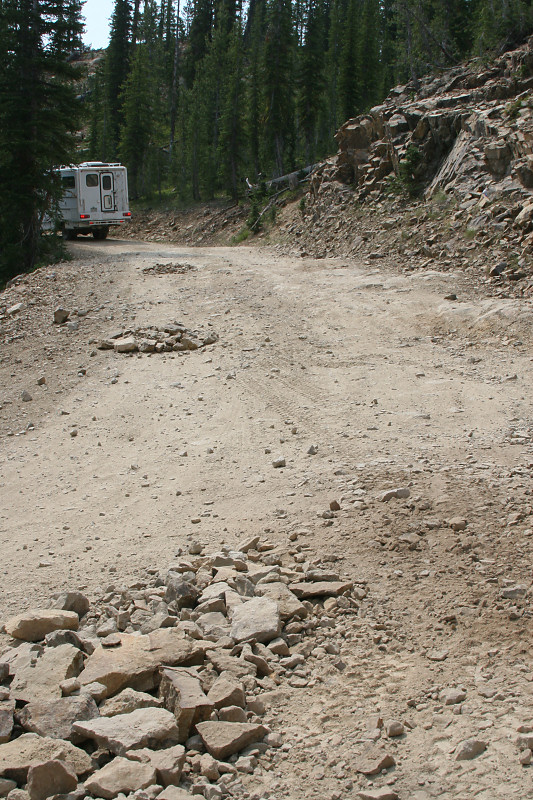

Occaisional road repairs.

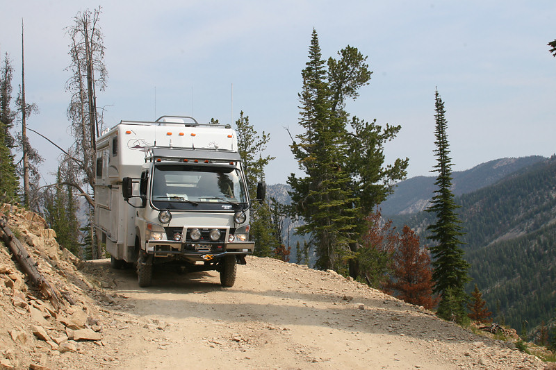

Great mountain roads. (River of No Return Wilderness)

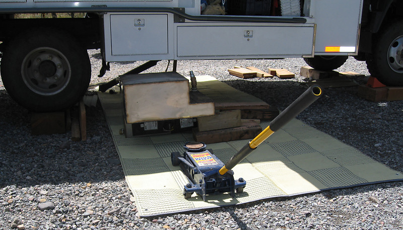

A few field repairs.

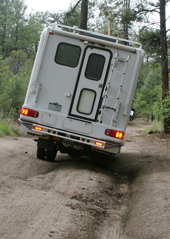

Some limit tests.

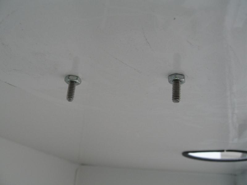

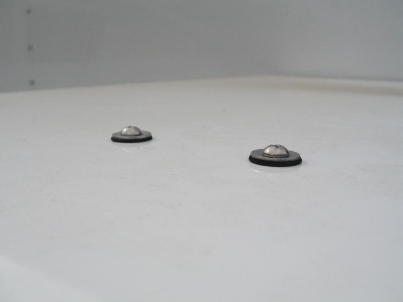

I tried to mount everything on studs so that if I needed to remove a component for service all I had to do was to remove the nuts & washers and then the component. This way I don't have to worry about getting to the backside of bolts, etc. that could be buried underneath things.
Here's an example from album 19 on the rig web site of the box lights. The heads of the mounting bolts are between the storage box and the camper. I don't want to have to remove the camper, ever, hopefully, and certainly not to fix a box light.
Mounting bolt heads (I later changed these to button head cap screws that use an allen head instead of a phillips head)
Mounting bolts with locking nuts (I used lock tite on these)

Brilliant! This kind of foresight must come from experience: like they say, "good judgment comes from experience. Experience comes from poor judgment."

Your rig looks awesome! I got a kick out of the contrast between seeing it in an Iowa pararde and the great outdoors. Finally, you get to enjoy the fruits of all your labors! I wish you and your wife exciting and rewarding, happy and safe adventures...and I look forward with much anticipation to your web updates.
Bon Voyage:jumping:
PS - I like your travel mantra of Exploring the World and Meeting Its People on the side of your rig along with the pics. I was half expecting to see the mantra in several other languages as well!
