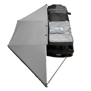

Today was a fun day. Awning day!
- built new taller aluminum brackets to replace the steel one provided with the awning then painted them.
- lined up the brackets to maximize strength against interior studs and pre-drill everything.
- installed Rivnuts (9 total)
- got that puppy mounted!
Send pretty simple but took me a while to decide of exact location and bracket style. As is, i can open/access it by opening the side window and from the side door, real easy!
Installing an awning is always a challenge with tall vehicle... but I think I nailed this one! :D
