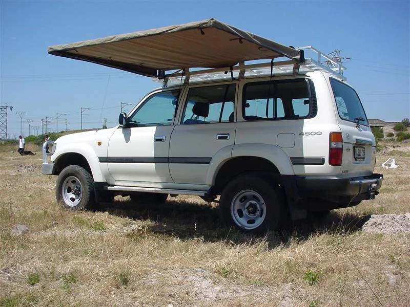

I don't remember taking any detail shots, but you might start with this one that shows (a grainy) shot of it stored in the shop-
http://130.94.161.162/images/LC/ken/_MG_8246.jpg
this one isn't very detailed-

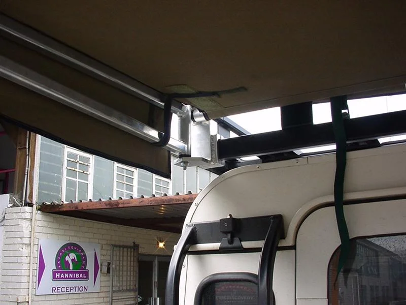

Hi there, this is my DIY of awning for my Defender90. Hope the photos serve you for your coming project.
this is the complete look of the awning (un-folded), not tighten and the canvas looks not so nice
this one without the side protector
the folded and tied to the load carrier look. chosed white color (inner) so that when folded it won't look too ovious on the road.
the hinge left and right
the main pole slotted into canvas before been fitted onto the hinges.
the end pole screw into the foldable arms with a butterfly bolts. the support column made from a shower curtain bar with a 3/4 pvc pipe holder fitted. (note that poor quality of garvenizing)
