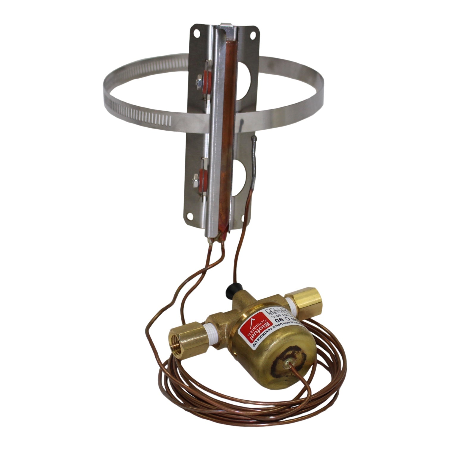

Dickinson sells a high temp shut off now
