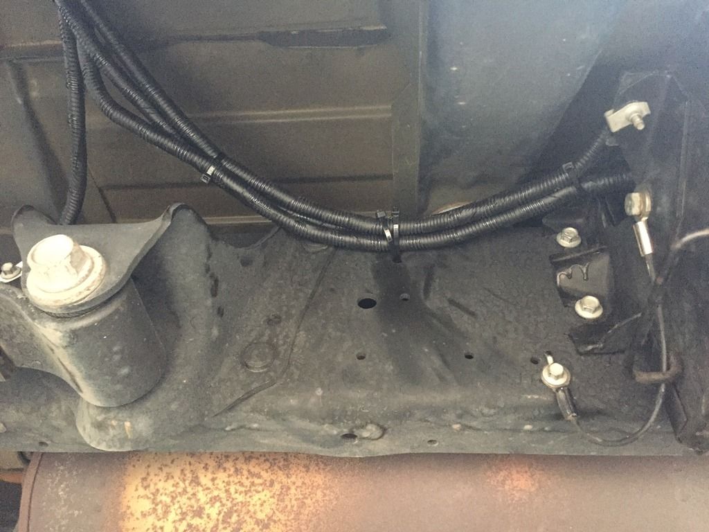

Here is the wire coming from the electronic tow battery under the frame
the remaining wires going up under the bench using a pre existing hole
