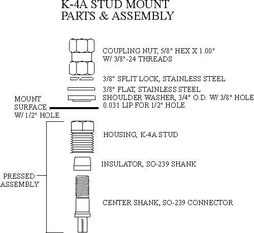

Make sure the center conductor and the shield are not shorted at the mount or the connector. Remove the antenna and put an ohm meter between the center conductor and ground. It should show open.
Like 93cummina said make sure that little piece of plastic is still in between the mount. I remember once I took that piece out because I thought it was just a spacer, had really high SWR readings until I realized, I put that piece back and it worked fine.
