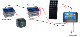

This is the setup (there are fuses, just not shown in the diagram)
I don't have high end needs so it's just two regular lead acids, voltage sensing relay, solar panel and PWM controller. The Solar and PWM have been working just fine up until now connected to the starter battery.

Vsr is fixed, 13.3 connect. 12.8 disconnect

It's the way the controller wanted to be wired and it's worked fine up to now. I've fat wiring back to the battery.
No shortage of fuses either, I was just too lazy to draw them.

Well that didnt take long! went out this morning and the VSR is disconnected and the house is at 13.9 and the starter is down to 12.5.
I've switched off the solar to see what the house battery does over the course of the day. The batteries are sealed so I don't think I can check for levels, but I can disconnect them, charge independantly and test.
Can also easily remove the VSR and test with a plain wire linking them.
have a 175W solar panel, would have to check the settings on the charge controller but 99% sure float voltage is set to 13.9
@NatersXJ6 you make an interesting point about cooking the battery. Maybe the starter battery has been on the way out for a long time, but the solar was keeping it topped up every day so I never noticed.
I'll monitor the voltages for another day or two and see what happens. I'm wondering if I'm on a hiding to nothing though with two old batteries and should I start with two new identical ones.

From the reported voltages it sounds like your batteries are properly isolated now. If the voltage sensing relay is working that way every time I'd look for a draw on the starter battery side or maybe your starter battery is showing it's age and dying. If the starter battery goes dead and your house battery stays charged then it's definitely not related to your house battery wiring. As for the current voltage readings, they're both fine.
