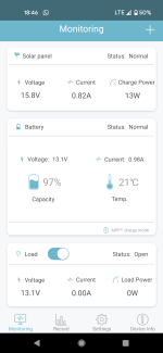

Just when I thought I was done with this.......
everything seems to be charging just fine. but the charge controller is flashing the load led with signifies a current overload whenever I try to use the pump or the cooler. it's a 20A controller and the pump and cooler are both on 5A fuses.
I know there's startup current on a motor but it has no problems with the fan starting. I thought maybe it was my connections or something this morning so I checked them and switched the output mode from manual to always on and it ran the cooler, lights and fan all at once for over an hour. thinking it must have been a dodgy connection I changed the output mode back to manual and it failed again. Thinking ok it's the output mode I put it back to always on but it's flaking out each time with an over current warning.
I've logged a case with Renogy but getting concerned now because we hit the road for the continent in 10 days. (I live in Ireland, going on a european trip this summer)
