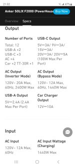

#3, off grid. Your loads listed are DC: puck lights, water pump, fan, maxair, vents, outside lights. The Anker isn't a great unit for running DC off of directly. It only has 3 usb c ports, 20v at 5A so 100w max each, and 2x 12v car charger, 120w max each.
So to power a dc trailer or Haitus setup, where you want to feed your power station directly into your dc fuseblock,you dont have a good dc source. You could plug the 2 12v cigarette lighter ports into dc block at 10a each, so 240w which isnt much loads at once, and You could run 3 usb c at 15v and 3a somehow and hope it's close enough to 12v for another 135w. I think usb c just auto sends voltage up to 20v, what the plugged in appliance requests, so I'm not sure about using them as 12-14v power supply... But now you have 5 wee cables jerry rigged to your dc fuseblock.
Or you could plug 5 separate items directly into the power station and not really have a fuse block, but thats not a great permanent design.
Lastly, you could use the 120v plugs, each 15A or the rv30 plug which is 20a, to power an ac to dc charger which goes to your dc fuseblock. This works nice on shore power as you have 1440 watt pass thru. Off grid you would have a lot of efficiency loss... anker battery to AC at 85% tested, back to dc via charger at say 87% since they use gallium nitride transistors. So, to use 1000watthours of your dc battery, you would only get 750wh actually to the dc fuseblock. That 75% efficiency instead of the native 100% it should be, is a bummer.
However, running off the rv30 plug, which is 20A supply on your unit, and using 87% efficiency onverting to dc, gives you 2088w to your dc fuseblock, plenty to run everything.

Hey DAVE IN AZ, WHAT DO THINK ABOUT THIS LAYOUT ?
Nice drawing ;)
Ok let's assume you are committed to the Anker, which I personally think is a good decision. It is a top power station today, with good 12v dc supply, and is mobile for use elsewhere. All the pickup camper shell popups are now coming wired for these. That thing does like 80% of all the boxes and lines on your drawing. It already has power converters, it has circuit protection and 15A limiting on its 120v ports, etc. First thing to understand: everything goes through the Anker, that is the heart, not a peripheral!
Here is what I would change:
1. Your 12v bluesea fuseblock, good choice, wire that directly to the anker tt30 port. Delete the "power converter", your Anker does that for AC shore power, and anker battery or future battery are already 12v. You might place a fuse at the bluesea on incoming wire, sized to the wire and specs on the bluesea, to protect wiring from future power stations or battery sources. Right now, anker will limit output to 20A, but if you later replace anker with say a 230Ah lithium battery, it could flow more amps than your wire to bluesea, or bluesea, can take. Maybe bluesea has an input fuse already, depends on model. But throw a fuse there, and run 10ga min for 30A, I would go with 8 or even 6ga for that one run. Highest amperage in system will be between battery/power station, and the dc fuseblock, plan ahead for growth!!
2. AC power to your anker: the cord you label "factory cord...to charge unit?", should go to your shore power. So all shore power just goes straight to anker, nowhere else. Delete the " 30a to 15a?" Line, the circuit breaker box, and the 120v receptacles. All your ac loads, devices, plug directly into the anker.
3. So the anker can do 1440w pass thru, that is it just flows from shore power right to the plugs and doesn't affect the battery once charged. That is 12A of ac. It can do more than that, like 2400w, but will use some battery charge. That would be plenty for me, but if you want to run more stuff when on shore power, like an airco or cooking equipment, then just run shore power to a small cb panel, to some plugs or directly to your loads. Then just plug the anker directly into one of your 15A 120v outlets.
4. The ac cb panel is there to protect the wire from shore power to panel, so size the incoming cb to whatever wire you run. Then individual cb protect each other circuit. Probably just 15a normal sockets, but an airco might get wired direct on a 20a circuit. And if you ran crap on all at once, you could exceed your shorepower wire, so the master cb on panel protects that.
5. I really don't know what a cargo trailer is used for, to me that means you arent living in there just hauling cargo, so a few dc lights. So #3 and #4 above wouldn't really apply. If you're living in there, then I call that a travel or camper trailer, and I can see higher ac loads if you use campsites and plug in. If I was doing a trailer I camped and lived in, then I wouldn't do it ANY of these ways, I would build my own battery system instead of solar generator, I would charge it with an ac dc charge controller, I would have an inverter to provide off grid 120v. And I'd have a solar mppt charge controller.
