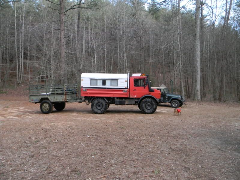

My friend's 90hp machine.
14,000 pounds wet and 90 ponies.
Gimme torque. Just lots and lots of torque.
Yeah, and doing 55 on the flats and only going slower from there on any hill (and that is without a load). I had a friend with a Mog, it was "fun" to mess around in, but he sold it because it sucked to actually drive. I like Mogs as much as the next guy, but 90hp is not enough, unless you like getting passed by loaded semi's (everywhere):victory:.
